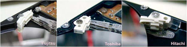

Reliability is a very complex criterion, which can be evaluated only on the strong statistical basis. Practice has shown that drives with less number of heads are more reliable. In addition, it is also important how the heat is taken away from the drive (a HDD with 7200 RPM heats way more than a 5400-4200 RPM drive). The higher is the heat level, the bigger are chances for the HDD to die. It has been also noticed that in the badly heated drives failures are usually fatal — it’s usually either a heads deformation during their unloading (parking), heads stiction to the surface, or a spindle stuck.
Heads deformation is a one the most fatal fault of a notebook HDD. This kind of fault comes from the Ramp Load/Unload system: the system consists of a plastic nest where the heads are unloaded (parked) after a power-down (see Figure 1). Naturally, as a result of heating, the metal parts (including a head slider) expand more than plastic ones; the manufacturers have considered that and reserved some margin, but often it’s just not enough. Being expanded a slider can easily fail to fit again in its nest, or simply stuck in there that can lead to its deformation after the next power-on (because an actuator will try to get the slider from its nest with the all possible force).
Figure 1. Structure of the ramp
Hitachi drives are the most vulnerable to the kind of damage described above. Toshiba and Fujitsu drives have fewer problems with that. However, one should keep in mind about Toshiba drives — they suffer numerous surface damages caused by heads. Being exposed to continuous heating Toshiba heads start adhering to the surface that can lead to radial scratches as well as create local bad-blocks. One more trouble with Toshiba drives — a spontaneous password setting. What’s more, this password usually fits with the highest protection standards, and also includes symbols that are impossible to tape using an ordinary keyboard (e.g. character graphics symbols). Sometimes this problem also occurred for Hitachi drives.
