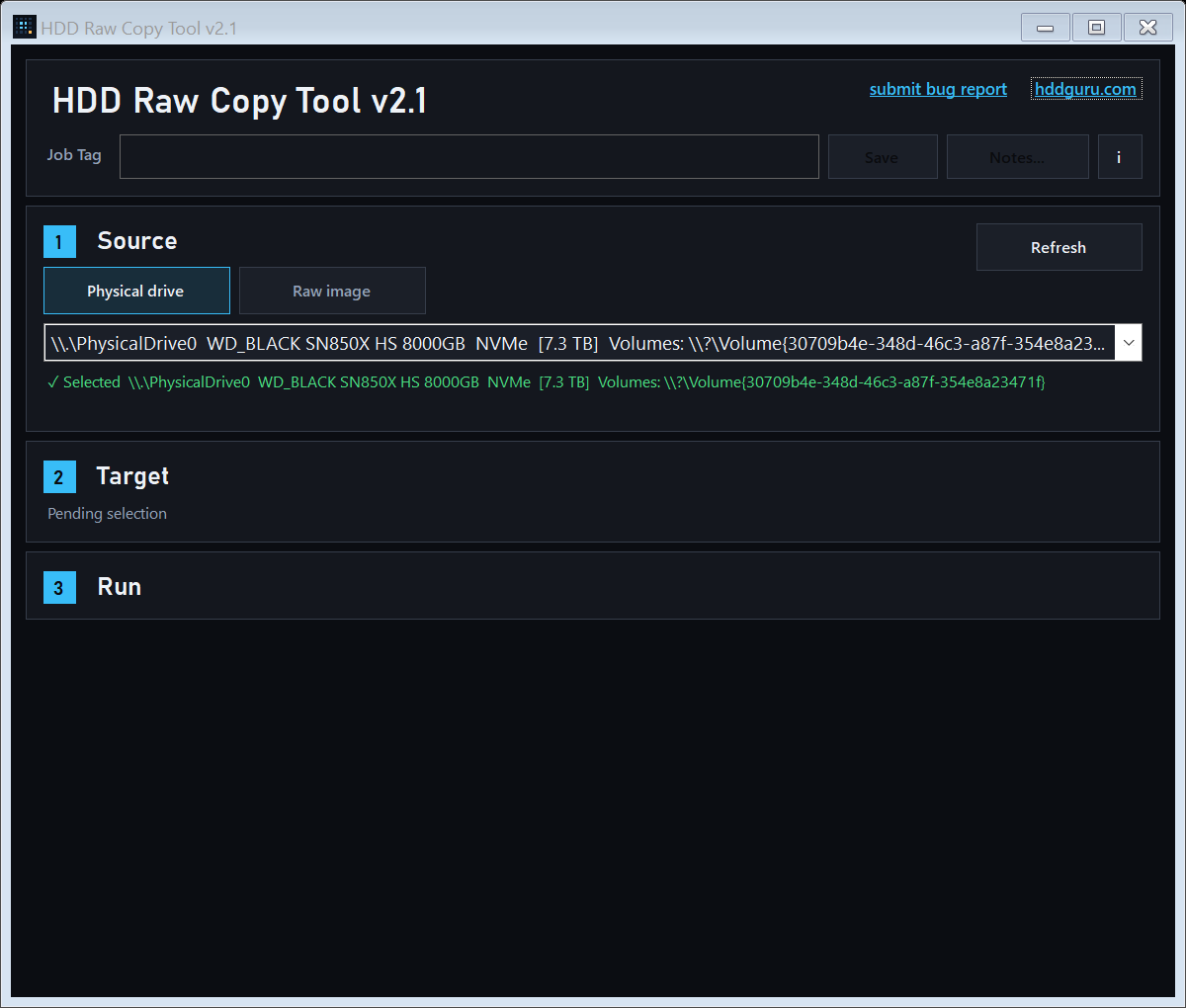

HDD Raw Copy Tool v2.1

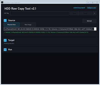

HDD Raw Copy Tool v2.1 – click to enlarge

  • Modern Windows 10/11 release with a simpler workflow
  • Resumable .imgcv2 images with embedded log, metadata, job tag, and notes
  • Optional hashing: MD5, SHA-1, SHA-256, SHA-512
  • Pause / resume and stop-for-resume-later for supported workflows
  • Read Only mode for source validation without writing an output image

  • For physical-drive work, run the tool as Administrator
  • For the safest physical-drive imaging, exclusive source access is preferred
  • File-only workflows, metadata viewing, and automation can be used without elevation

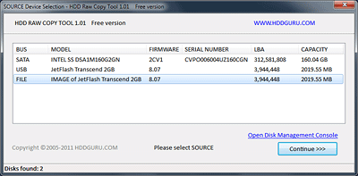

HDD Raw Copy Tool v1.20 – click to enlarge
