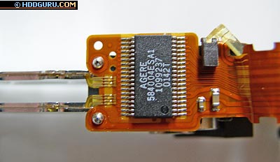

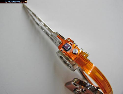

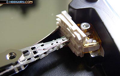

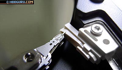

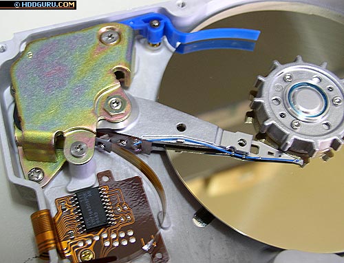

What is a preamplifier?
It is a small chip, located on a head stack. In old hard drives the preamplifier is usually multi-pinned; new models are made with an open-frame type of preamplifiers that attached either by using conductive adhesive directly on contact areas or by soldering accordingly to BGA principles (Figures 1, 2).
Figure 1 — a head stack with an open-frame preamplifier (Hitachi ATMR series, 2.5-inch drive)
Figure 2 — a frame-type preamplifier (Seagate Barracuda IV drive)
Working with preamplifiers always includes some difficulties, because, practically, they can not withstand static discharges. If re-soldering is needed, one should follow a number of rules to protect a preamplifier from static damage caused by careless finger touching. Simple protection includes: ground connections for the drive, for a soldering station, for the repairer; and using a 12-volt soldering station.

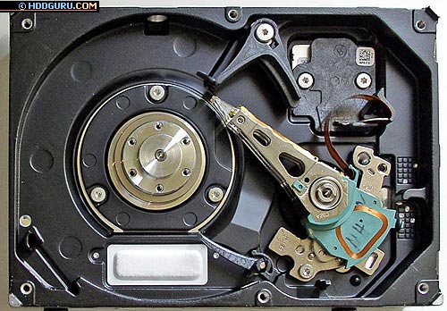

Old hard drives with their obvious reliability (here we mean 20...512 MB drives), are gradually dying; one of the reasons for that is exactly a heads’ problem. On the Figure 3, a “lifted” head of the 406 MB Quantum Pro Drive LPS is shown. The “lifted” head is a very serious risk, because it scratches the platter that can lead to a severe surface damage. Besides being “lifted”, heads can be also plucked out — it’s been a quite typical trouble for IBM drives. Of course, this trouble doesn’t happen that often, but if it occurs, an exposed area will be destroyed completely.
Figure 3 — “lifted” head of the 406 MB Quantum Pro Drive LPS

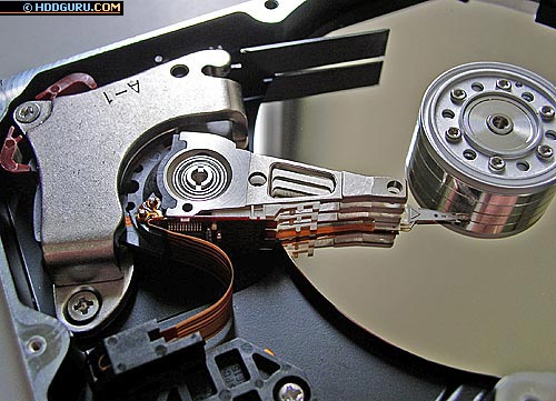

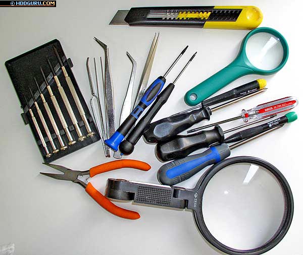

After a clean place is ready we can start with choosing necessary tools (Figure 4).
Figure 4 — tools for head stack replacement
First of all there should be a set of screwdrivers of different types and configurations. Then, the process will require curved and straight tweezers. Also a magnifier and an office knife will come in handy. Then, get a good lamp preferably with flexible/changeable light direction and a good PC power supply unit. Finally some alcohol, gloves, a face mask and a hair cap should be added: obviously because a person himself is a big source of dirt — hair (dust) and fingers (grease) — therefore it’s important to protect a drive from all these factors.
So, when a preparation step is completed successfully: all tools are ready and a decent level of cleanness is achieved — we can proceed to replacing a head stack. The first thing one will need here is — practice.

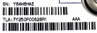

What is a donor? And what are the rules of compatibility?
The donor is a hard disk drive a head stack which we will use to replace a dead one in the original drive. The general requirements for choosing donors are: an absolutely identical to the recipient model type of the camera, identical spindle control and VCM chips and read/write channel chips. Besides that, for every manufacturer and for many drive series there are specific requirements about the donor selection — they must be followed in a combination with general requirements (see Table 1).
Yet, even having the same model name, totally identical PCB (drive electronics), we can still be unpleasantly surprised after having opening the donor — the heads there are different and so they can’t be used for replacing. It is possible to avoid this “surprise” if use characteristics of compatibility, provided in Table 1; for some drives, besides those characteristics, it is necessary to check a serial number which gives information about the number of heads. It is very useful, especially for Maxtor drives. For example, author has seen Maxtor 6Y120L0 hard drives (120 GB) with 3, 4 and even 5 heads. It is possible to define the number of heads by looking at the serial number for Maxtor, Quantum and Seagate hard disk drives (Figure 5, 6, 7), namely:
Figure 5 — a serial number of Maxtor 7Y250P0 (250 GB). The second character of the serial number stands for the quantity of installed and being used heads
Figure 6 — a serial number of Quantum Plus AS (40 GB). The third symbol of the serial number shows the quantity of installed and being used heads
Figure 7 — a serial number of Seagate Barracuda 7200.7 ST3200822A (200 GB). The third symbol of the serial number represents the quantity of installed and being used heads
Looking for donors for these drives one should also check an identical firmware revision or identical symbols in the alphanumeric codes on the labels.

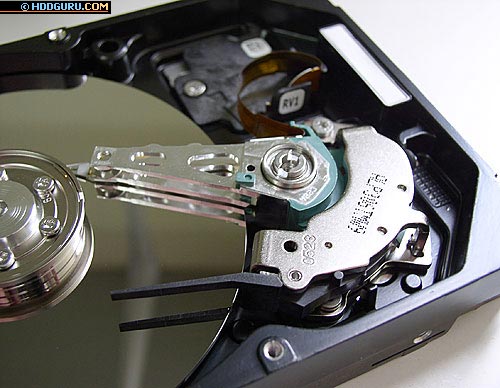

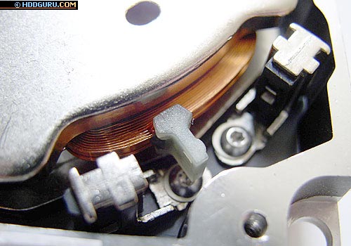

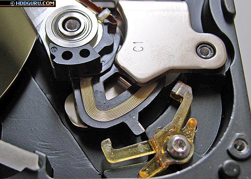

Figure 8 — Seagate Barracuda 7200.7, 40 GB. Firmware 3.06, one head is on the upper side of the surface
Figure 9 — the same drive with a plastic airlock visible

Heads load/unload system

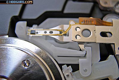

Practically there aren’t that many types of heads load/unload systems. Roughly, they can be sorted into an “external” type systems (heads are parked outside the platters), and internal type (heads are parked directly on the platters in a special parking zone).
The external load/unload system is being used in all modern 2.5-inch drives since it is much safer. Besides that, it is being used in IBM and Hitachi 3.5-inch drives (Figures 12—14). The external load/unload system can be also found in SCSI hard drives — with up to 12 heads being unloaded!
Figure 12 — A load/unload zone with unloaded heads (IBM AVER series, 40 GB)
Figure 13 — Heads are loaded onto the surface (Hitachi AVV2 series hard drive, 80 GB)

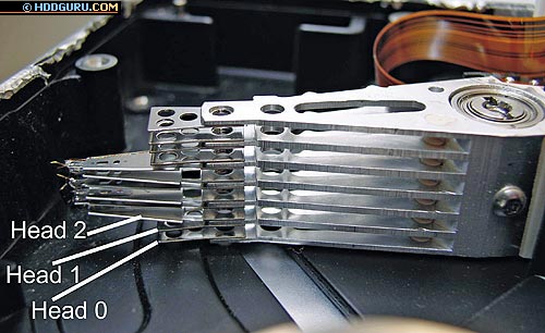

Why heads are numbered starting from zero?
There is a simple reason for that — everything which is related to electronic devices is guided by mathematical laws. In mathematics — 0 is still a number like 1 or 100, and in decimal format or hexadecimal (HEX) zero starts the numerical row. Traditionally in HDD manufacturing a HEX format is used because of several reasons — one of them is explaining that to determine big numbers you need less characters (e.g. number 255 will be given in hexadecimal format as FF); besides that, a standard two-byte word makes 16 bit, which has also become a reason for choosing HEX format.
Heads are counted starting from a lower (bottom) head — the lowest one has number 0, the next following has number — 1, and so forth (Figure 21). It should be noticed that even when heads are physically missed, they are still given the numbers (Figure 22). On the Figure 21 (a damaged head stack of WDE9180) it is shown that the numeration starts from head 2 and we can see that two lower heads are missed.
Figure 21— A heads numbering scheme (SCSI Western Digital)
Figure 22 — A head stack (WD600BB) — heads number 0, 1 and 3 are physically present; head number 2 is missed

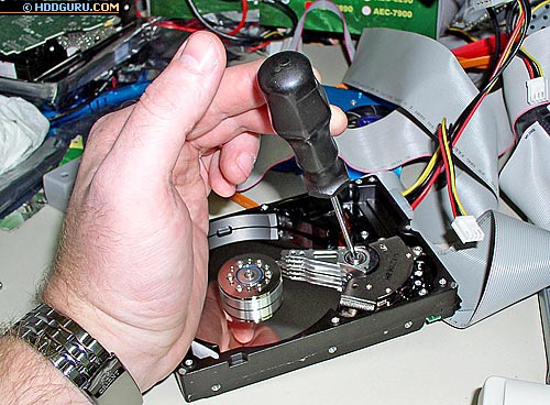

Ground yourself!
Now, let’s get down to the main question — how to do heads replacement? First, we need to pick a donor. It may happen that we will need more than one donor — when surfaces are damaged so much that, during the reading process, heads literally “burn out”. As the examples of cases when more than one donor is required we can mention hard drives Quantum Plus AS and Maxtor D540 — D740X.
Next step — we clean up the donor and the recipient, better off by applying an alcohol on their bodies and PCBs — the main source of dirt is here. Then we put them into a “clean chamber” and start the process. If a drive has screws that fix the spindle and/or head stack on the lid, they must be released first. Only after that we can move to the remaining. Now, we have the drive opened. To take out malfunctioning heads we need to partially disassemble some internal parts of the drive.
It’s recommended to start with an upper magnet of a position control system. Take off all screws that hold it, then grip the magnet by pliers and take off the magnet. Note that magnets are very strong and in case if it slips out — the hit will be very strong and consequences unpredictable.

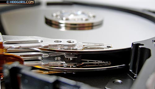

After taking off the upper magnet we can see a VCM coil and a position control system (Figure 23). Now we have to remove screws that hold the connector (on Figure 23 — in the upper right corner of camera). Only after that we take off the elements of a load/unload system. If your hard drive has an internal load/unload system, then you should take the heads out of it first (move them through the platters), while doing this you should spin the platters, and without stopping spinning move the heads outside the platters.
Figure 23 — an inside structure of a position control system (Seagate Barracuda 7200.7, 160 GB): a head stack, a VCM coil, the load/unload mechanisms
Why is it needed to spin platters when moving heads? The answer is simple: heads can stick to the surface if moving without spinning.

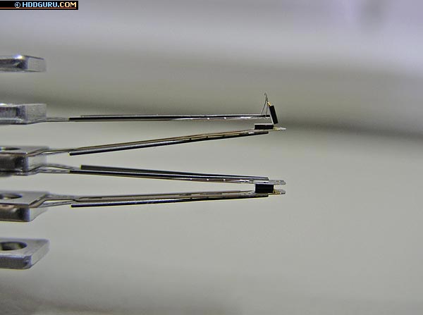

Before taking heads out of platters, we should take measures for them not to stick together. If there is only one head — no worries, but if there is more than one — then paired heads in the block can stick together. To prevent this we can put one of the paired heads in a special container. The author uses thin drink straws that can be prepared next way: a straw is heated up to the level that is close to its melting temperature, after that the straw is flattened to a desired form (for example, by putting a ruler on it and waiting until the straw gets the right form). Then the straw can be cut into pieces which will be used for packing the heads. We can apply the same method for storing used heads.
If a drive has more than two heads then to pack the difficult-of-access heads from a lower levels properly we will need thin curved plastic tweezers.
So, the heads are moved out and packed. Now we release the screw that holds the axis of a head stack, and carefully, by moving directly up, we are pulling the head stack off. During this procedure it is very important to remember that a head stack can not withstand static discharge, and therefore, it will be ideal if you are working being grounded and using gloves. A head stack must be pulled off by using tweezers or combination pliers — taking a head stack by hands can cause damage to wires which coming from the preamplifier to the read-write elements.

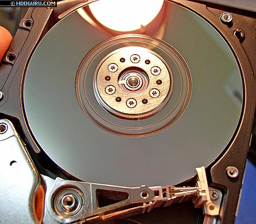

Having done the same procedure to a donor we will get a set of good heads which we can place into our recipient drive. We will start with putting a head stack on the axis by using tweezers or combination pliers, and then tighten the screw.

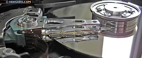

Next step — loading heads on the surface. That is actually the most difficult part. If there is 1 head or 2 heads — it will be done easily by moving the heads apart using tweezers. In case of more than 2 heads we will need either ten hands or a special tool for moving the heads apart — from this point everything will depend on your imagination and how you would like to do this; the author uses paired tweezers and plastic straws for this purpose.
After heads have been placed on the surfaces, we are accurately moving heads towards the parking zone while spinning the platters. For drives that have an external load/unload ramp it is needed first to put back the ramp. If during the loading process you hear any strange sound — creak, scratch-like sounds, you need to move heads out again and check the accuracy of all steps. If you decide to leave it as is, the drive will spin up and then, most likely, heads will damage the surface.
Have already moved heads on their place without incidents? Well done! Now we put back all internal stuff, and then move to a next difficult step — putting back an upper magnet. To complete this task we fix the drive tightly, grip the magnet by pliers and carefully put the magnet back on its place. When it is finally placed, we correct its position and fasten the screws back, and after that we can turn on the drive. If everything is done correctly and with decent accuracy — the drive will recalibrate, be detected, and we will see our data.
